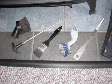

2 months now and here is a summery of my experiences:
- Pulling the burn pot cleanout daily (or more) while stove is off. After the 1st couple of weeks the cleanout became VERY hard to pull..carbon buildup, so I tried the Dremel trick and it worked great. I have since started adding some corn to my mix (about 20 Percent) and the carbon issues have not returned...very minor clinker but much cleaner burning stove. I plan to continue adding corn.

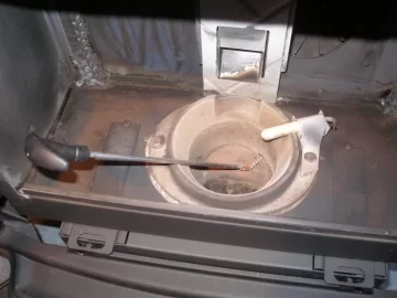

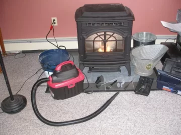

- I am cleaning the stove very 2 - 3 days....after 3 days the ash pan is almost full. Cleaning takes 15 minutes after stove has cooled off. I remove the top and rear baffles, sweep all ash into traps, brush down all interior surfaces including heat exchanger tubes, the vacuum everything. I use a gun brush on the burn pot air holes and lastly wipe the glass with damp (water) paper towel.
see pics of cleaning tools I am using.
The worst part of cleaning is actually cleaning the vacuum when the filter plugs up!!

Good writeup. You're cleaning tools are almost identical to mine except I have a Loveless Ash vac and after every use it has a rod that allows me to shake the filter clean in seconds for the next use and works great.

Love my Castile as well!! Nice read and pics! one question..what diameter is the brush you use to clean the air holes?

My tools are very similar but I went with a Rigid 6HP with Hepa filter and drywall bag. What a sucker! Does a fabulous job.... just make sure the stove is cold and no embers! I have also been thinking a grinding down that hopper control so I can lower the pellet flow from the auger. Even at the lowest setting, I think too many pellets are dropping into the fire pot....... like minds!

First season running quad castile stove no problems ran 2 tons through the stove. I use the med setting and feed rate is set in the middle. Clean stove with vac every Sat. clean pot and ash pan daily. I use 9mm gun bore brush for the air holes in the pot.

The gun brush I referred to (and shown in picture of my original post) is .22 cal it is a bit big for the smaller holes by the bottom cleanout and maybe a bit small for the other holes but seems to work OK......by the way it only takes a few extra seconds to remove the back and upper baffle plates and clean behind them..I highly recommend it if you are already in there with the vacuum.

Peirhead thanks for the tip using the dremel tool I also use pam to soften the carbon on pot door works good. Try a 9mm or 38 bore brush there larger and fit the holes better. I have worn my brush out and need to buy a new one.
