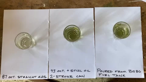

Thanks, @gzecc. I had been thinking of trying this, not sure if I’d be able to tell the difference, but you convinced me to go out to the barn and check it out. The difference is day and night, there’s definitely some oil in this gas:
[Hearth.com] 2 stroke seized!
Close up:
This doesn’t tell us the ratio isn’t too thin, eg. Stihl screwed up their 2.6oz bottle dosing or we’re just seeing residue picked up from old mix in the jug. But given the very noticeable color difference, and the fact that the thing ran at least 15 minutes before failing, and that this is not a new batch of fuel… a fuel mix problem is looking less and less likely.
Close up:

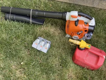

Thats a good result.
Problem solved! New blower, and fresh batch of fuel for extra precaution:
I will do a teardown autopsy on the old one, but that will have to wait for August or September. I have some other big projects on the docket ahead of this.

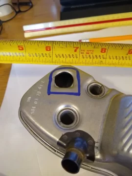

Muffler with hole drilled but before deflector was added. I also drilled out most of the internal baffle, which also had a small hole, about the same size as the little pea shooter outlet shown below. :

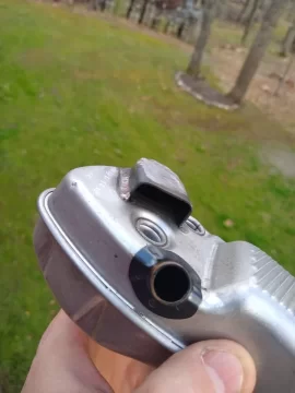

After deflector:
