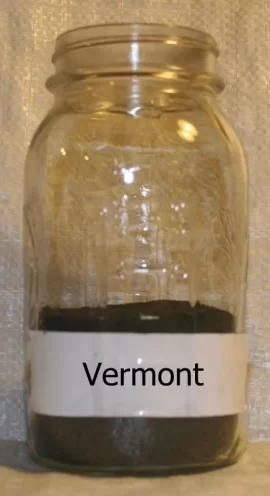

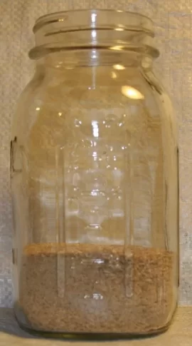

Vermont Wood Pellets results
Temp average 249ºF
Ash volume 12 ounces
Ash weight 3.25 onces
Ash Percentage 0.246%
Density 42.76 LBS.
Fines volume 8 ounces
Fines 3.63 ounces
Fines Percentage 0.276%
Bag Weight Bag 1 41.03 LBS
Bag 2 40.41 LBS
Diameter .254
Length 1/4 to 1 1/4
Total Burn Length: 27 hrs 37 min

  • [Hearth.com] 2010-2011 Best Softwood Pellet winner...

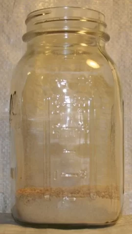

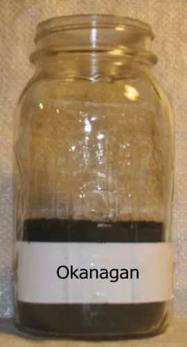

Okanagan results
Temp average 265ºF
Ash weight 3.68 onces
Ash Percentage 0.284%
Density 44.98 LBS.
Fines volume 4 ounces
Fines 2.08 ounces
Fines Percentage 0.161%
Bag Weight Bag 1 40.59 LBS
Bag 2 40.28 LBS
Diameter .255
Length 1/4 to 1
Total Burn Length: 23 hrs 42 min
