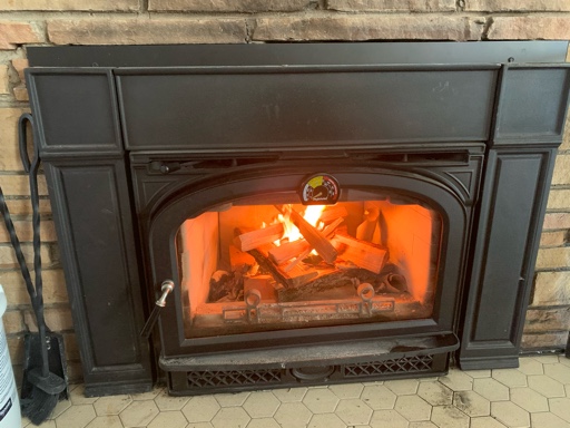

Just wanted to say hi, wish everyone a happy new year burning in 2020. Enjoying our VC Montpelier it’s our second winter with it in the basement. We use it mostly on weekends to heat the kids playroom. Looking to add another stove into a open fireplace
In our living room in the coming year.

Looking good! Happy New Year.
