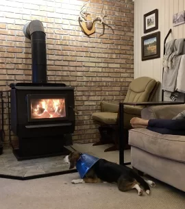

I see more than the dog warming up next to the fireFirst fire of the season in the Princess tonight. Converted to NG with a high efficiency furnace this year so I’ve been slacking. Nice to feel the stove heat tonight!
Dog quickly found his place.

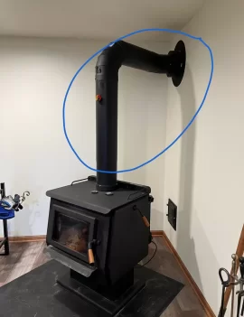

That should eliminate all of that build up. My barn stove was set up like that originally, but the horizontal was around six feet, it dripped creosote.Did my clean out about a month ago. I cleaned out about 2 cups of dry flaky creosote in the section highlighted in the picture. This section Ts into a straight ~20ft section that goes out of the roof (this section is insulated). In the 20 ft straight section, I cleaned out easily less than a cup of dry flaky creosote. This is my first clean out with this set up and I was expecting it to be the opposite (more creosote in the 20ft section) and it's got me puzzled. No issues with my burns - i'm easily getting 20-24 hour burns (with an active cat the entire time) and performance has exceeded my expectations overall. Just curious about the build up on the lower section of pipe (which is double wall).
EDIT: The section in the picture was a 90 degree bend all last year - I just replaced with 2-45s after I did the clean out
