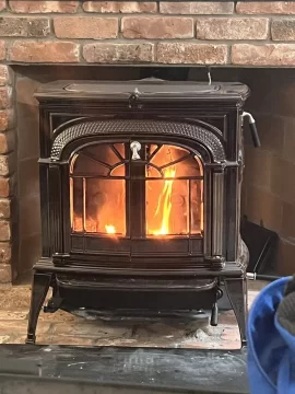

Hi,
I am strongly considering buying a Vermont Castings Intrepid Flexburn that was manufactured in February 2021. The seller wants $1,200 for the stove, interior pipes and all of the accessories shown in this picture. It looks to be in great shape and was barely used (the seller bought a house where it was installed). The glass has been cleaned since the pic was taken.
I live in the woods and would be using wood from my property to heat at the most 1,000 - 1,300 square ft. (the reason there is a range is we are having a small addition put on our house).
The house is an A-frame and the stove would mainly be used to heat our main floor (kitchen and family room: 700sq ft footprint) - half of that would be single story and half will have a 100sq ft loft above it. The house has a heat pump-oil conversion system, but we would like to switch to using the wood stove as the main heat source - and certainly when we lose power.
I grew up in a house where we used a wood stove as our main heat source, but it was a steel stove that my dad made. I don't have any experience with a catalytic system.
I would love to hear from anyone who is using this stove! Any information, experience, advice, etc, etc would be great!
