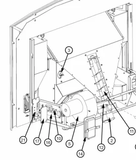

If you installed the stove your self you would be able to reset the switch
Just pull off the surround panel
Locat the Limit switch
it is on YOUR right on the back side of the unit
See attachment #3
has two wires and between the two wires is a RED bottom
if you push on it is will snap and reset
if not this is not the problem
