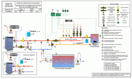

I followed a diagram like this one. The only thing that has not been done yet is install the aquastat on the tank. When complete would I be able to use the oil boiler in the summer to heat the tank and provide hot water.
At first glance, it doesn't appear that there's any provision to heat DHW with oil in this schematic.
If it were me, I wouldn't heat the storage tank with oil anyway - too much standby loss with all that surface area. I'd look at either an electric with sidearm ar an indirect tank for your DHW, in either case preheated by passing the cold water through the coil in storage.
