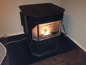

Had my first burn yesterday into today. Burning green team oellets with pipe going directly out to a clean out T. Haven't gotten oak installed yet. Stove is on 1-4-1. Ran on 1-1 all night while I was at work. Prob 70 percent of the glass was covered in soot when I got
Home after about 13 hours of burning. Turned stove to 5/6 and flame was rather large. Large as in constantly licking the top of the chamber making the stove on top very very hot to the touch. Heat coming out was great. Just wondering if this was normal operation or if I can maybe tweak something so get more out and less dirty glass. Thanks in advance!!

High flame? Turn it up to 8-9 and post a pic.
That was very helpful, I can post one soon however it's in the 60s here now lol. But I will try to higher levels. My default was 1-4-1 for sure. Im kinda fuzzy too, getting finished a 12 hr night shift.

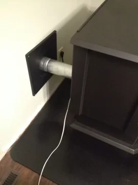

While you are doing that don't be surprised if they give you the please install that oak before playing with the low burn settings speech.
I assumed that would part of the convo... Plaster and brick are a damn PAIN.
My house isn't tight, it burns really well the way it is lol.
It sucks putting another hole in the house, but if the manual says you need the OAK, you must install it. If it makes you feel any better, my thimble and OAK look like they were installed by a 2 year old :p
[Hearth.com] 25-EP soot glass and huge flame[Hearth.com] 25-EP soot glass and huge flame
That's it set on 1/2 cooking us out working on convection loops to get the bedroom up. Currently 67 back there.
