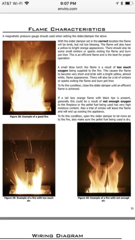

My problem is I think that at least my bottom auger is turning too fast. It appears to be turning at 1 3/4 rpms. I am also burning through about 40 pounds of pellets in 10-11 hours on Heat Range 2, Blower Speed 9. This was with my LFF on 5, LBA on 4 and AOT on 1. It’s in D mode.
If this is a problem I’d like to get it taken care of while still under warranty. I’m not sure how to check the rpms on the top auger.
After I used up the pellets that I had in the auger (I’ve only burned about 60 pounds so far) I went to close the restrictor plate a little but found that the bolt was stripped.
I have high hopes for this stove and want to get it running right.
Your running about right. You could drop down to 4 4 1 and that will slow down the feed a bit. The key it to get the burn correct.
