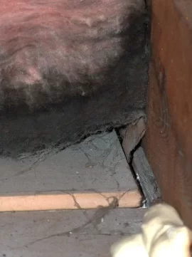

Zeta,
Here's an attic air leak before we nailed it. The foam you see is from a bathroom remodel I did three years ago. As to the foam itself, I used the Soythane stuff as well. Worked pretty well, but the gun is a b!tch to use in tight spaces.
