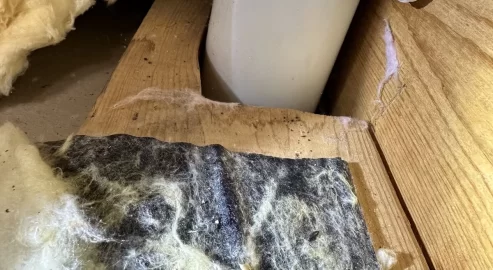

So I think I may have narrowed this down to a vent pipe coming through the ceiling in this joist area. I really don’t wanna spray foam it, in fear of causing another issue I can’t undo further down the road if need be. Is anyone aware of an airtight fabric or something I can stuff around the gap where it comes through the ceiling? I’ve stuffed insulation in there for the time being ti see if that helps, but I know it’s not airtight. Would much rather put something in there I could remove if need be instead of spray foaming.

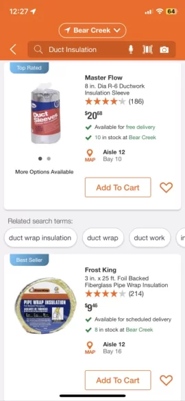

This is what I used to cover a duct in my attic. You can get various diameter sleeves. Or just the roll and wrap it and form it as you see fit. I used the foil tape on the seams to keep it in place.
I’m hoping this is the culprit. The toilet vent pipe coming up through the ceiling drywall. This is the same joist area where all the frost is forming. Just foamed it all up. Once the foam dries I’ll lay all the insulation back on top. Fingers crossed

Good detective work.

I FINALLY got this figured out at the end of winter last year. When we replaced the shower 3 years ago, they had to move the drain over. When they did that, they cut a new square hole into the subfloor obviously to accommodate the drain pipe. They never replaced the insulation around the pipe. The air from the crawl space was rising up into the hole, up the back wall of the shower, and into the attic space, creating the moisture when the warm air mixed w the cold attic air. I filled the hole w insulation, and no more issues throughout the rest of the winter.
