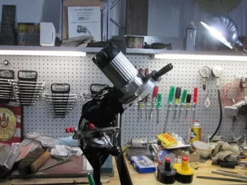

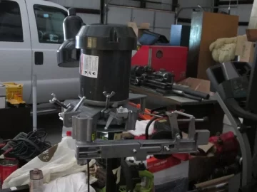

Thanks, the pics I posted was the day I made the new mounting bench. Everything is at chest level so you can really see what is going on.
With the Simington, not only are the angles critical, profiling the wheel correctly is too?
I have watched the videos on the Simington web site. Looks like the learning curve is pretty steep on getting proficient with the square grind. Unreal how they cut though. Got a picture of that by chance?

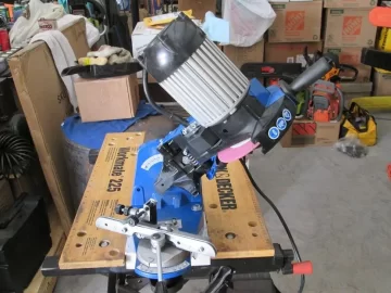

I like this for the round grind:

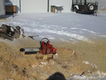

Here are a few pics.
The last picture is my Husky 272 with a 20" bar 72 dl chain that I converted to square grind.
I like the saw because it cuts the noodles fast and clears those long chips good,

Those pics were taken today. We had about 7 inches of snow yesterday.
