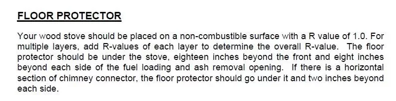

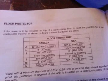

The myrd and austral are ember protection only
If you use double wall pipe its 6" clearance from back of stove to wallI do not see that as a problem as I have a concrete floor
That is not in my manual, I have seen people post it needs r1 and others say ember protection only, my manual is this year with no r-rating.. Labeled drolet ng1800 wood stoves on coverHmm, maybe my manual is dated?
