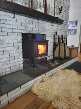

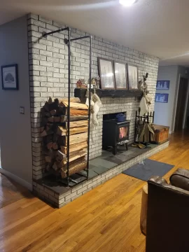

Show us a picture how it’s installed. I have an F400. I run a blower on thr floor blowing up the back. I have an insulated block off plate too. This one is completely silent at speed 4 or lower.

Here's 2. Blower is attached in the back. I have it plugged into a "smart plug" so I can just turn it on with my phone because it was a pain to reach around the back. Its a variable speed with dial. I have it on medium unless the stove seems like its overfiring I will put on high. Pleased with how quiet it is.
  • [Hearth.com] Upgrade

Here's 2. Blower is attached in the back. I have it plugged into a "smart plug" so I can just turn it on with my phone because it was a pain to reach around the back. It’s a variable speed with dial. I have it on medium unless the stove seems like it’s overfiring I will put on high. Pleased with how quiet it is.
do you have a block off plate. A quick look at the EPA test reports shows the F55 v2 tested at 80k BTUs per hour on high. That’s WAY high. 6kgs per hour! The TN was like 30k.

That looks like a big and open room. I don't think that stove will cook you out.

Yes, i have a block off plate with rockwool behind it.
