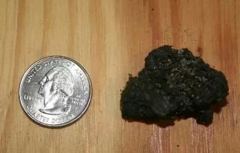

Can some one post a picture of a clinker so that I can see what you are talking about . I a green horn . I am still on my second bag .There doesn't seem to bee any dust in these pellets ,I don't know about clinkers ,I don't think so but not sure what they are ,hardly any ashes .

....here's one compliments of Jay........ cc :cheese:

Thank you I think I had one of those yesterday .I will pay more attention now . I think I put my fire place tools away to quickly I may still need one or two of them .

cc I have copy rights to that there photo(and clinker).
I will have to charge $.25 for use without authorization!
JK- :cheese:
That's one wimpy clinker Jay.
I wouldn't waste time trying to pursue a copyright infringement suit, the judge just might laugh you out of court because you didn't throw that undersized one back.
After all there are minimum length limits ;) .

See Jay.... Smoky seems to indicate that 'size does matter'...... anyway I apologize and your 2 bits is in the mail.... if you don't get it in a little while, keep waiting...... :lol:

You 2 got a bigger one? Lets see it!
Least I got one to show and tell even. :-P

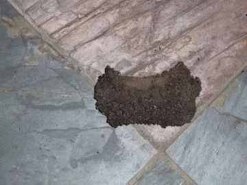

Don't know how this will turn out but anyhow here goes.
This is from a July 2008 batch of Maine Woods. I haven't seen anymore since that batch I'm currently burning a late January 2009 or so batch.
  • [Hearth.com] 3 clinkers a day

Don't know how this turn out but anyhow here goes.
NOW THAT'S A CLINCKER. I don't even want to know what brand of pellets that's from. Uggg. :sick:
Jay,
I updated the post to let you know what was burning that produced that clinker. It filled my burn pot and part of it is missing because it broke when I removed it.
Now you know why folks were a bit upset last year.
