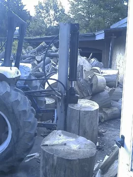

I usually split by myself so for one person operation it works well - not too slow, not too fast. Mine also can go vertical and I have done this for big rounds.

  • [Hearth.com] 3 pt. wood splitters
