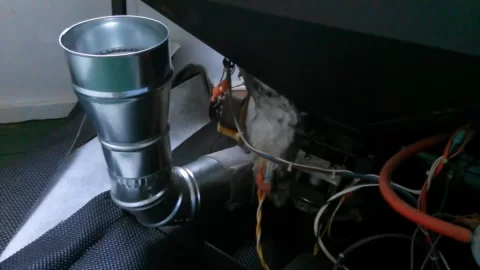

Just emailed Breckwell (P23 insert) directly for their take, but figured I'd ask the experts here and probably get a better answer, faster!:) See photo and tell me if this should be fine, or no way Jose. 3" elbow with 3" to 4" increaser. Steel, but not stainless. I'll be venting 4" diameter straight up a masonry chimney with approximately 25ft of 316 flex. Yes, new clamps will be used at all connections.

Can you fit a clean out T instead of the 90* elbow?
I just liked having the clean out T for running a brush up the pipe and was very handy to clean out.

That wont work! That looks like dryer vent pipe.
Yeah you will want a clean out on that puppy. Inserts can be a b&%ch to clean without one. You will get ash in the elbow which can and will restrict airflow. IMO

If I go with a T, should be SS, no? Can I get one that's 3" to 4"? I would think there's a huge demand for that setup.
Get all 4 inch pipe including clean out t...then buy a 3-4 stove addapter to hook into the exhaust pipe.
