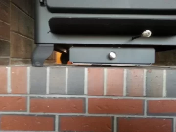

I cut mine so that the ash pan is about half an inch off the hearth. It didn't hurt anything as far as the stove operating properly.

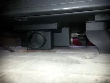

did that put your intake box in the back on the ground? or is it still up off the floor back there ? im trying to visualize it through about 6 beers and it aint working, was planning on getting him some measurements tomorrow when I go play in my lab but if you measure and post em it would work as well (im going to anyway)

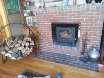

Here is the thread with a few pics where I chopped off the legs. I'm assumming your going to be sitting it either completely or inside your fireplace.
https://www.hearth.com/talk/threads/there-is-a-new-nc30-sitting-in-my-garage.119845/

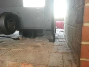

It's pretty close. It sits right where the ash clean out is conveniently enough. I fed my blower cord down it into the basement. It seems to pull cool air up it as well.
ok, makes sense, strikes me when ive had to pull a pedestal to weld something under there the stove sat "nose down" a bit when it was sitting down with nothing bolted under it

Thankyou for pics that's the look I want! Prob cut my legs exactly like yours once u give me measurements. Out of curiosity do you stack the nc30 full for overnight ? Going to be a new experience for me with this stove compared to my old beater

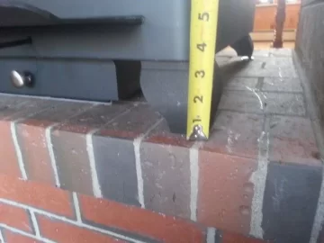

Here are some pictures I took today. Mine is 26 inches from the bottom of the legs to the top of the flu collar. Left me about an inch and 1/2 to squeeze it in there. Once it was in it was fine. Had 3 inches clearance on the front lip.
