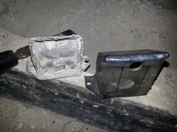

Hey all, we are on our 3rd or 4th winter with this stove . The stove usually burns 24-7 from October thru early April . The air inlet piece in the front bottom of the firebox has seemed to burned out. The side of the inlet facing the back of the box and part of the top of it just crumbled and letting all the ash fall in there now and I have to keep cleaning it out with every loading. I think it was originally just a small hole on the back side the air shot out of.
I wonder if any of you have had this happen. I did a search and couldn't find anything.
This Spring I was planning on replacing the boards, tubes and re gasket the door. I hope I can get this piece too, although I couldn't find it on their site.
I will call them on Monday and see what's up and keep you guys updated.
They call that the doghouse. It appears to bolt on so should be easy to replace if those bolts come out nicely.
O good
Easy to change out. Held down with two sheet metal screws. First one I have heard of getting burned through. The cool air flowing through it into the fire should keep it from getting too hot.
Give ESW a call.
When you swap it out, do yourself a favor and use neverseize on the new screws, just in case you need to do it again.

For the record this is a first about the doghouse burning up and my best guess is you got one fabbed from bunk steel - unfortunate but sometimes steel is of less quality than others. That, or you live on the ocean and have heavily salted air coming through your stove.

That damage is not surprising, given that the stove was run wide open. I'd like to see more pics of the innards of the stove.
Innards of the stove and the chimney. 4 years of running it wide open. Did the pipe ever glow?
I run most need hard but not wide open. The doghouse seems to always feel sorta scaly on the fireside. I feel the hole to be sure it isn't blocked. Lots of heat right there up front.

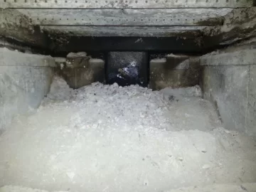

Pics as requested. Yea, it needs shoveled out.

Doesnt look too bad inside from what I had expected but you do have some issues starting with the re burn tubes. The ash being left in the stove for long periods of time is most of the problem. That ash combines with moisture from the air and creates a caustic lye that eats away at the components of the stove.
When you are done this year shovel it out, take a shop vac to the inside and give every thing a good coat of WD-40 to keep this to a minimum. I have do this for the last two years and the inside of mine looks nearly new.
I don't do any wd-40 but do shovel out the ash sooner than you. You're giving up valuable wood space in that firebox! If the doghouse rotted due to the ash then I would expect all of the metal to have rotted. I instead agree with above that it is something else.
If this happens again, there has been one other member that replaced that doghouse with a block off plate.

Were the bolts seized in there pretty well or did they come out easily?
Nope black as can be. I burn hickory, black locust, red elm and other hot burners too.
Hmm ... Never knew. Love hearing informative posts. Thanks for the info. I will do that from now on.
Susprisingly they backed out real easy. Replacing them with new ones.
