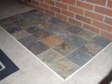

In case it's helpful, I have tile flush with the surrounding floor. Here's a pic. Just replace my crappy carpet with your nice wood.

Excellent! Looks good!

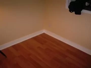

I'm going to do a cardboard cut out of the stove dimension and figure where my clearances are then tape down the hearth pad dimensions around it and see what becomes of it. I'm thinking I might be able to pull the trim out and possibly remove the sections of laminate in the corner and then cut and replace as needed. Trying to think it through, probably less messy if i just cut the outline of the pad once its here.

With the 15" clearance of the stove from corner to wall and the 18" clearance needed for the front I think the pad needs to be moved a couple inches out from the wall. That is factoring in that the trim is actually 1.5" deep. Is the trim really a factor in determining clearances? The other issue is there is a window, and I need to make up for the clearance to the blind. The window is going to get smaller with more wall space but not until after the install. Actually not until the spring!
