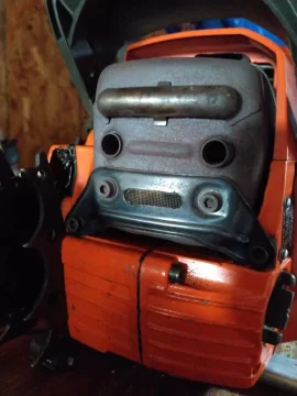

I've run a dual port muffler on my Stihl that was from a rescue saw I believe. I may do this one like the xtorq saw he had through the muffler brace.

Jftr, I doubt you'll get anything but noise with a muffler mod on that saw. It's just an empty box with two decent sized holes in it already.

Two holes? I only seen one in top. I'll have to look again.

I may have mistaken the two front holes for exhaust holes when they are bolt/stud holes? I didn't see the top outlet...those top outlets can sometimes melt the front edge of the cover a bit. I put some foil tape on the underside of my 262xp's cover to alleviate that. It is problematic on the 262 and may not be on the 372.
anyway, rather than opening up the stock muffler (thereby ruining a part of a fine example of what is a collector saw to some folks) you could buy another muffler cheap that already has bigger outlets. Just a thought.

It does just have a top outlet. I have a roll of foil furnace duct work tape. Would that be sufficient to put under the top cover above the outlet?

Done the dual port mod to the front through the muffler bracket and assed a screen in between.I'll get a pic up. Didn't really gain anything. It's set a little fat right now with the 24" bar. Need to stick it in some. Didn't have to adjust the H screw at all. Stock muffler has no baffles in it nor had any from looks of it

You gained noise. And ruined a pristine stock muffler. Oh well. Your saw.
for 20-30$ you could have had a chinese muffler to play with. I have one on my 2152. It was 20$. It seems to be every bit similar quality as the stock muffler but full of all of the epa junk.

These older Husqvarna must not be as choked down like the stihls.

I don’t see where you hurt a thing with that muffler mod. New OE husky 372 mufflers will set you back around $60 if you decide to undo it. In my personal opinion no one should be running ANY chainsaw for more that a minute without ear protection anyway so I actually love the way a muffler modded saw sounds. I have a piped muffler on my little 450. Sounds sooooo much better than it used to.

I don't believe it did. This muffler had not internal baffles and I didn't have to really adjust the H screw much at all but I believe it was set pretty fat. Cylinder had lots of crosshatch left on it so it was worth pulling the muffler to look if nothing else. If I change my mind I can always replace the front brace with a new one to cover screen and hole
