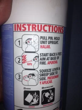

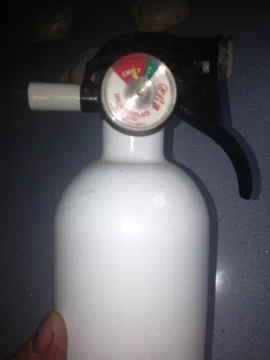

Hello
Agreed, instead of pointing the finger we need to ask what can we all do to prevent these disasters. Loosing a home is the worst outcome.
I had classroom and field training on different levels of fire extinguishing to prevent loosing a home or Biz regardless of what might have started the fire. The field training consisted of each of us taking turns putting out a fire with a fire extinguisher. Great training!
Having a minimum of 2 extinguishers in a home gives the owner who in many cases is at the scene, a chance at saving their home. This training should be available at local fire departments but it is possible to find.
My next door neighbor lost their home and everything in it even though someone was there when a pot was left unattended on the kitchen stove.
Just having an inexpensive extinguisher that can be purchased at Home Depot is great insurance.
I am in the process of updating one that I have.
