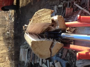

From my experience, even on large rounds, the first cycle yields 4 splits. The bottom 2 are usually ideal to go straight into the stack. The two halves have to be split again, which is normal even with the 2 way wedge except you have already gotten 2 splits off of the bottom. The distance between the horizontal wings of the 4 way and the main rail on the splitter is about 3 inches. Not quite sure if that description makes sense.

I use one with my Swisher in horizontal (set screw for vertical) . With large diameter log I take a couple of splits off with leading edge of wedge then center to split remaining block into 4. i find that works better than trying to center split every block. I Split smaller stuff with leading edge too for just over kindling size
