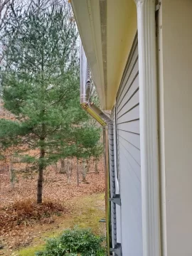

45º elbow offset
Excuse me. The last time I checked that is what Canadian code said. I said I believe because honestly I don't check Canadian code often because I don't work in Canada and don't need to know it the way I do US code. But what I said is not an opinion it is based upon reading actual codes. I doubt they changed but can't say for sure because I don't have a copy of current Canadian code.
I'm curious about the US code for this issue. My pipe was installed by a licensed chimney pro and inspected by my town building inspector. None of them have an issue with the 45° offset (ICC Excell) used to get around my gutter, I even mentioned to my chimney pro that I didn't think it was legal. Job was permitted for a woodstove. Are there any situations that you are aware of where this would be allowed under our code? Many thanks for your time @bholler

Are you sure it's a 45 and not a 30? 45s aren't even available for sale here.
Again just because something is permitted and passes inspection doesn't mean it meets code. Inspectors miss stuff all the time

I didn't think 45s would be sold here either @bholler , maybe people use them for oil flue?
My insurance company is aware that the pipe and stove have been installed by my pro and inspected by the town.
Is the only proper solution to take down and replace with 30° offset?

That definitely looks like a 45. Yes the only way to fix it is by changing them out for 30s.

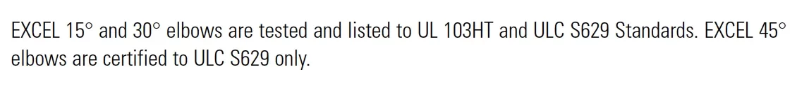

It sounds like the installer didn't read the fine print in Excel's catalog. The 45º elbows are only ULC (Canada) certified, not UL certified for US use.
