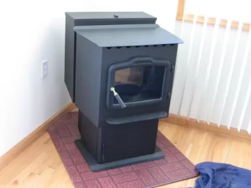

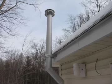

They mean 4' for the exhaust to be away from the windows, not where the stove is to be placed. Look at my pics.
Pic 1 shows how close the stove is by the windows.
Pics 2 shows that the vent is MORE than 4' from the windows.
If you go straight out, you'll have little draft, in case of a power outage, smoke can return in the house. That's dangerous, especially if you have the unit on during sleep. Do something like I did and have peace of mind.

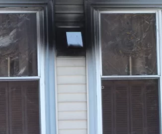

This guy keeps his windows closed %-P
  • [Hearth.com] 48" away from windows?
His pipe is also too close to the house, and it doesn't look like he cleans his stove very often (or ever).
