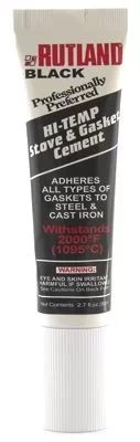

Home Depot and Lowes tend to think people only buy heating products from November to January. They love to put out the lawn mowers and bar b que grills in February so you have to find a stove shop or smaller hardware store that sells stove gasket material and glue. The clear liquid stuff has failed me more than once, but the thick black stuff is some solid stuff when it's cured. The Rutland product works for me.

The local hardware had that Rutland cement, so I got a tube of it....see how it holds up.

Definitely the Rutland cement, that's what PE sent me as the top joint of the T6 failed only after using the stove for a month and it was covered under the warranty. You have to watch out for the thickness of the cement bed you r using as this may affect the overall tightness of the door.
