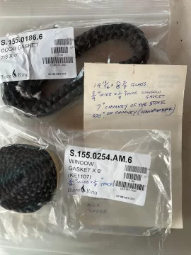

Here’s OEM, purchased about 18 months ago.

@Murray01 thanks, but I can't tell from pic - is the window gasket thinner in the middle, or uniform thickness ? If so, that would be a dead giveaway I didn't get OEM.
Where'd you buy from ?
Window gasket is usually a uniform thickness. The package should have the BK part number on it and their logo.
For RTV, I have used Permatex Red on the door gasket and it has stood up well. I will be replacing it soon and will be curious about how eay it is to remove and clean the gasket channel. I think Highbeam used their copper RTV. Don't use the blue, it sets up like rock.

Uniform thickness, 5mm thick with brown paper on the back sticky side stamped 3M. Purchased at a small town brick and mortar hardware store. They don’t stock OEM door or window gaskets, special order. If memory serves it was about $65 for gaskets compared to their off the shelf gaskets that would have been around $40. Comparing the OEM and off the shelf window gasket the OEM gasket is way stiffer than the flimsy off the shelf gasket.
Same can be said with the door gasket, considerably stiffer than off the shelf stuff.
