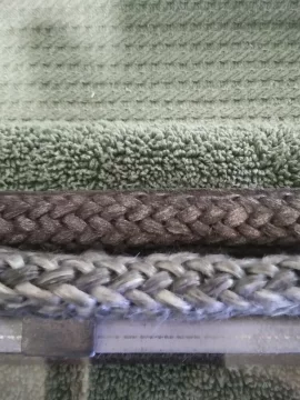

When the stove arrived, I checked the area below the door opening. It also angles inward similar to my original stove. It may not be quite a much. The door does seal completely around; top; sides; and bottom. I did notice that the OEM door gasket is a different material and weave than the the replacement door gasket kit SBI sells. (AC06500). I took the door from my replacement unit and put it on my original unit. The door did not seal at the bottom.
Therefore, I have a replacement unit which does seal completely. SBI did not want the original stove returned. I will use it for spare parts; baffle, bricks and burn tubes. While I appreciate that SBI stood behind their product, it was frustrating that the communication was so sparse.
I now hope that this winter I can spend less time fidgeting with the stove. I want to be able to get the heat from the stove and not have it go up the flue. I want the secondary flames to burn via the burn tubes and not at the front of the stove. Time will tell. OEM Gasket vs. AC06500.jpg
