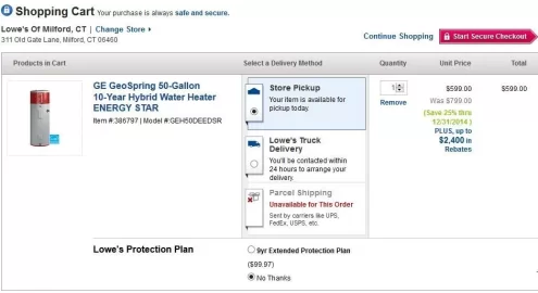

Also, for those in Connecticut. These units are now $599 at Lowes with rebates available.
