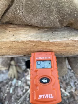

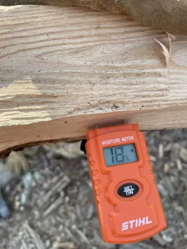

I did realize that it probably wasn’t on the “ash” setting. It’s brand new, cut some cherry logs that have been down for 12months and it said they were 30%, but very fragrant and heavy. Standing dead locust that was cut 12months ago and it’s less than 20%.I've never seen a reading that high. Especially ash. Sure your meter is accurate?

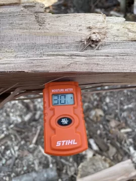

Wow, those growth rings look really wide apart. That must be Green or Black Ash I guess?Thought I had a dry standing dead Ash tree. Felled it and checked it with my meter….

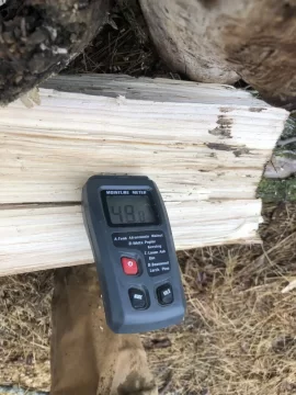

50% haha. Some of it was dry below 20% but only a few branches. The trunk was very wet.
If you have some 42% wood stacked in Sept. that's now at 20%, that would seem to support the "free water" as opposed intra-cellular water theory, if that's even a theory. I just started reading a little bit about it wood drying, and I'll have to pick that up later, I glazed over pretty quickly just now. 😆I had the same dead Ash tree go from 19% from the top part to over 42 at the trunk... Surpisingly even the stuff I split and stacked in Sept still reads above 20%

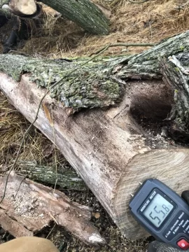

Smaller ones with the bark fallen off, maybe. Big Oaks with bark off, maybe....40%+. 😖Whenever I hear people talk about cutting standing dead trees, and it being ready to burn off the stump,
