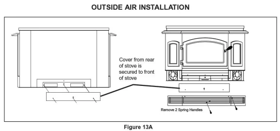

I am about to remove my 5100i in order to properly install a much needed block off plate (thanks to all the helpfull advice I've received here). After reading through my manual again, I'm curious about the outside air plate mounted on the back of the stove. My fireplace has a hole in the back of the floor where a metal door once was for ash. I just have a large piece of sheet metal sitting on top of it. There is also a metal door on the back of my chimney in the garage which certainly isn't air tight.
Should I leave the outside air plate on the back of the stove? Should I seal the ash removal door in the garage?

Webmaster said:
Unless it is needed for code, I would not go the OSA route with your stove and your house......it is likely to make the steel of that stove very cold when the stove is not in use, and will also lower the internal combustion temps.
Actually an OAK may improve combustion, raise combustion temps and heat his house more effectively. I'd recommend adding one if he could. Introducing air that is 100 degrees coolers than air from the house isn't going to significantly lower inside stove temps, but it is going to slow down house air exchanges and in-leakge, reducing heat losses in the home. Most OAK's also pre-heat the incoming combustion air somewhat.
