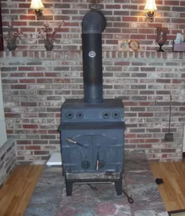

Similar to the original poster, I have a potential issue. I have an old Fisher Papa Bear woodstove (I think - See attached Picture) and I have been thinking that I wanted to get a new modern Drolet Sahara EPA stove. There is a Drolet Dealer at one of the big box stores here in Atlantic Canada that carries them, but the kid that I was talking to didn't seem to know much about woodstoves in general.
The new one that I want has a 6" flue collar and the current stove pipe and insert that I have going into my chimney is 7". I do not like the thought of having to shell out even more money to get a new insert installed when the insert that I have is fairly recent. Would 1" really make that big of a difference if I were to put an adaptor on at the flue collar to bring the size up to 7"? Is this typically a fire code or insurability concern?
The interior pipe goes to an outside brick chimney that has a 7" insert in it. The stove that I have now heats 3 levels of my home beautifully, so I want to make sure that I get a good quality replacement. All of the EPA wood stoves that I see around here have a 6" flue collar.
Thanks for the help!

...The new one that I want has a 6" flue collar and the current stove pipe and insert that I have going into my chimney is 7". I do not like the thought of having to shell out even more money to get a new insert installed when the insert that I have is fairly recent. Would 1" really make that big of a difference if I were to put an adaptor on at the flue collar to bring the size up to 7"? Is this typically a fire code or insurability concern?
It's neither a code issue nor an insurability issue, it's a performance issue. I don't think that going from 6" to 7" would be a problem. Rick
