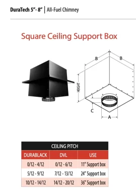

Sorry, I probably confused things more than necessary. I do plan to use a single-wall pipe from the stove up to the cathedral roof chimney support. I'm trying to figure out how close to that roof box I should be when I put in the expander to go from 7" to 8" (single wall). If I understand correctly, the roof support box will transition from the 8" single wall pipe to the 8" double wall. The top of the stove is approximately 12' below the ceiling.
Thank you for the information.
The expander can attach directly to the start collar on the support box. Some already have the crimped connector on the bottom of the support box for this.
