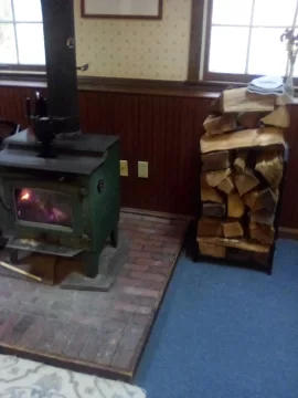

Cool. What are you getting? My house is less than 1100ft. I liked the idea of a bigger stove for longer burn times but it can get into the mid 80s as is. I also read its better to under size slightly, to burn more efficiently. Makes perfect sense to me. Im hoping i get longer burns or at least extended heat output because its cast over steel. My vista was just steel. Fast to get hot, quick to cool.

Nice. Going from 6 inch to 8" pipe, and even with burning less than seasined wood in the past, I havent seen much creosote. I almost bought a used Hearthstone Shelburne. Super nice stoves! New its out of my range and i came across mine so i grabbed it. But i love the idea of soapstone. Congratulations!

What you got it a much better and more durable stove. I would have burnt it the way it was without a second thought but you are absolutely good now

Thank you. I thought i could have too. I just get a little paranoid somtimes. Always a risk but i want to eliminate as much as possible. I live alone and like to be able to let it roll all night.

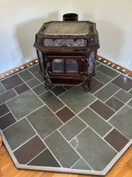

Thanks. It's going to look nice. Here is a pic of a Hearthstone III stove I saw on craigslist. It has the exterior soapstone and it's pretty ornate. They want 2k for it. I think they're a little too high. That stove was built between 1984 and 1990. It's actually 2 years older than my stove. They say only lightly used 😂 The other thing is it looks to me like the soapstone on the top is different than the sides

Yea I wouldnt pay 2k for that old. There are simply better deals to be had. Way better. Just have to be patient. Good eyes as far as the difference in color on soapstone. Unless its discoloration id be a little leery. Only issue ive thought about was the soapstine cracking. Not sure how easy it is to replace. I dont over fire so I wouldnt be worried if they weren't cracked at install.

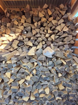

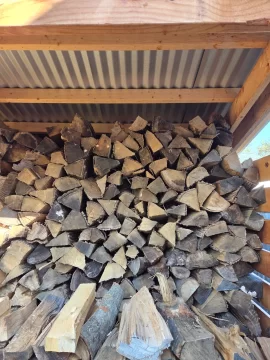

Quick question to anyone on this thread. Is thete a problem with too low moisture of firewood? Ive heard a hundred times about wet wood. Put a meter to several pieces of wood i have from a year ago and its reading between 5 and 7%. Ive read it can burn too hot and fast. I dont care about the fast part. Ive read it can damage a woodstove because of heat, and even create creosote. I dont want to go down a rabbit hole here. My common sense tells me if i go by my heat guage and keep it less than 500...which i do....ill be ok. Until i get to know this stove, im not going to load it up and hope it doesnt run away on me. Its a weird problem to have, wood thats that dry, but the other batch i have is 25 to 35%. Planking of lettung that season so i can use next year.
If air dried, it’s unlikely to get that dry in our area. With a kiln you can get it that dry easily.
Too dry of wood could off gas too fast under the right conditions and be hard to control. If you don’t stuff your stove full to the max, you may be able to control it just fine if you go in expecting the wood to act differently and keep a close eye on it.
I think most issues with this sort of thing are from when a person is used to burning wet wood and suddenly switches to over dry. Say they cut up some nice kiln dried 2x4s from Lowes. They’re expecting the same fire behavior and the fire ends up being much livelier.
Gotcha. Thanks for your reply. Wood is air dried oak, ash, maple, and some cherry. I absolutely watch the stove and will definitely do yhat with my new one. My moisture meter could be a little off too but i think its close. I cut smaller pieces too a lot to dry out good. Ive had wet wood before and dont like it. To look at the firewood it doesnt seem like disinterested. I just dont want to damage stove or create excess creosote.

To be sure of the MC, split a piece of each species of wood and bring them up to temp in the house and then check the MC. I have a small rack next to my stove that I keep a couple of days worth of wood and being 18 inches from the stove, the wood dries a bit more while it's waiting it's turn. I just checked an oak split that measured 16% about 10 days ago was at 11% now.
Wet wood causes creosote. The threshold is 20%. Under 20 and the wood should be ok, I like around 15% myself.

There is no where in NYS that you are going to air dry wood down to 5%. If you aren't checking on the fresh edge of a piece that was just resplit you are not getting an accurate reading.
