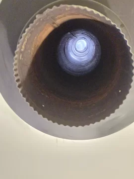

Fairly new to burning wood and made a dumb mistake. I replaced my woodstove with a new Pacific energy T4 Alderlea and left a bath towel in the stove pipe before hooking it up. I tried 2 small fires to break stove in and wood wouldnt light. Lotta smoke in the firebox and a few puffs out of tge chimney cap. I used fatwood and dry wood..that didnt burn well.
Anyway, I cleaned the entire chimney but creosote was formed and dripped down the pipe adapter. Im sure theres a minor amount in the chimney. Do I need to be concerned about trace amounts? Should I clean the chimney pipe clean again? 6 inch stove pipe is connected to 8" metalbestos insulated chimney pipe. Thanks!
Fairly new to burning wood and made a dumb mistake. I replaced my woodstove with a new Pacific energy T4 Alderlea and left a bath towel in the stove pipe before hooking it up. I tried 2 small fires to break stove in and wood wouldnt light. Lotta smoke in the firebox and a few puffs out of the chimney cap. I used fatwood and dry wood..that didnt burn well.
Anyway, I cleaned the entire chimney before installing new stove but creosote was formed and dripped down the pipe adapter. Im sure theres a minor amount in the chimney. Do I need to be concerned about trace amounts? Should I clean the chimney pipe clean again? 6 inch stove pipe is connected to 8" metalbestos insulated chimney pipe. Thanks!
If the wood was dry there shouldn’t be much to drip. Do you have any pics? How long was the wood stacked to dry?
That’s a small stove to try to run on an 8” chimney. The velocity of the smoke may be too slow allowing the creosote to form.
Not sure if you caught this, but I mentioned that I had a bath towel stuck in the chimney pipe. I plugged it up because I was waiting to install the new stove and didnt want cold air into my house. I made 2 attempts at fires before realizing what ive done. Wood is dry and fatwood burned great. Plenty of draft, even with the towel in the pipe. I guess not enough to light the wood though. I also closed the door before the wood started to burn. Probably didn't help.
I caught the towel bit. But creosote thick enough to drip often takes more than 2 quick, unsuccessful attempts at fire with dry wood.
I hope removing the towel fixed all your issues and you’ll only get a light coat of soot in there from now on.
Oh ok. I appreciate it. I haven't tried another fire since i took the towel out. My question here was do i need to clean the entire chimney again because i saw the creosote? Do i need to worry that the dried drippings will ignite if i light another fire?

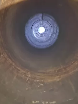

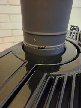

Good morning. I'd like to try and help, but without pictures of what you are talking about it's hard to tell if it's safe or not. Where exactly are you seeing these creosote drips? How long is the stove pipe/ connector pipe. How far up the chimney was the towel? Just in the bottom of the chimney pipe?
When you removed the towel, did you look at the inside of the stove pipe below the towel? How'd it look?
Post a picture so we can help you figure this out.

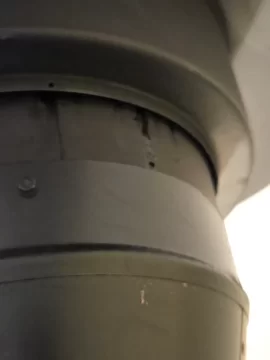

Towel was just above the woodstove. Into the pipe maybe a foot. I used 2 fatwood sticks, which burned quite well. The other wood just wouldnt catch. I also closed the door pretty quick after lighting. Ton of smoke in the firebox. I tend to think the drips were incomplete combustion and fatwood resin.
I noticed that the 6" stovepipe didnt come completely clean. Ill take it down this weekend and clean it good. The 8" chimney pipe looks very clean since i cleaned it a month ago. I have about 6 feet of 6 inche stove pipe connected to probably 14 feet of 8 inch insulated chimney pipe. My original stove which was about the same size drafted like crazy. I could control the fire but if i wasnt careful it could have hit 700 degrees.
Im going to go back and use the whip cleaner with my drill this weekend. It will be as clean as i can get it. Going to make double suremy wood is dry, reconnect and try a fire. If theres any creosote in the flue it will be trace amounts. Seeing thise drips freaked me out. I dont want them to ignite or have a chimney fire.

I use fatwood myself. I can see them causing that. I would say you most likely don't need to clean the chimney pipe above where the towel was. Looks like the towel had it blocked up pretty good. That's a pretty small amount of creosote/ resin/ ? outside the pipe. I would try to clean it off a little especially near the stove top collar.
Don't do too much scrubbing on that as stove pipe shows abrasions pretty easy. Try using an alcohol wipe on it. Or whatever you have...
You can also buy some stove pipe paint and re-paint those areas if they concern you. I wouldn't do that until after the burning season is done.

I really appreciate it. I kinda had the same thing in mind. The chimney pipe is real clean. Im not worried about painting the stove pipe. I will clean the outside spots and re clean tge inside of the stove pipe, as i can see the whip didnt clean it as much as I thought. I didnt really crank the drill on that section.
I agree about the fatwood smoke. I even have brown honey like resudue on the glass from it. Im shocked it burned like it did. I stuffed the towel tight into the stove pipe. I think it just shows how much draft i have here. Without the obstruction of the towel, im sure its going to light right up. Was just concerned about the dried drippings of creosote causing a fire inside the chimney, or outside of the pipes in my living room.

I wouldn't think so. Based on what I saw, it isn't all that much. Ultimately, it's your decision and I don't remember hearing anyone say they were too safe when it comes to fire. Stay in touch as you go. Keep us updated on this thread. It's always a bit of a learning curve with a new stove. Also I've added a co detector and fire extinguisher near my stove. Also co detectors are usually required outside the bedrooms. I have a gas water heater so I have three co detectors in my house. One at the water heater one at the woodstove and one outside the bedroom doors. Additional piece of mind. And, of course good working smoke detectors in all those same locations.

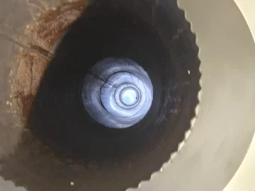

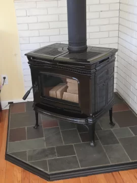

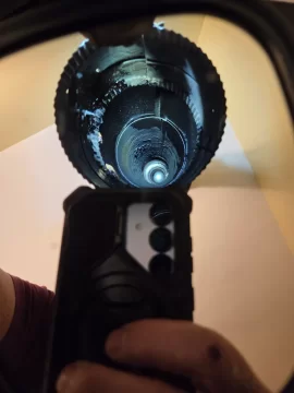

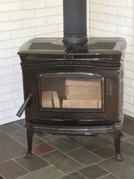

Ok.... Take 2. Cleaned and put back together. About as much as I can clean the flue without taking the entire chimney down. Towel is gone. Minor residue from fatwood on the inside of slip joint that goes into the bottom of chimney. Im assuming it will burn off. Going to buy a fire extinguisher and that chimfex stuff and start burning..probably tomorrow. Wanna see it during the day. Im also assuming the creosote on inside of the glass will burn off too as i use it. Ill write back after the first fire.

You can let it go and see if a good fire will clean it up. The glass can be cleaned as long as it isn't hot. I use wet wadded up newspaper or that brown paper that comes in the boxes from online stores. Dip in the ashes in your stove and it will clean that guck right off. Since you only really burned the fatwood... But, I looked back. Is that stove new or used? If it's used you don't need to do break in fires, but I would keep it small until you get a little more comfortable. Definitely keep the door cracked for a few minutes until the fire is started up pretty good. Probably something in the manual about the recommended sequence for that stove. That pipe looks fine. I look forward to the continuation! :ZZZ
Thanks buddy. This stove is brand new. Guy said about 9 years old. New, old stock. Pre- epa. Hes a dealer but no longer carries pacific energy. Was a leftover. Got it for 1600. New im pretty sure would be around 4k. Was worth it for me to travel a little to get it, hook it up myself ect.
Ill see if regular burning cleans the glass. Only thing that would make it perfect, perfect is placement of insulation blanket on sides of baffle plate. Its perfect on one side and not placed perfectly on the other. Considering my old pacific energy didnt have any left on the sides im not worried. This set up is about good as it gets. My first brand new stove. Im pretty excited!

You should be! That's a really good price for new/old. First it's a great looking stove. It's a non-cat, so less to worry about. I came really close to buying a T5 in brown. Ultimately I went with a different stove, but I really like the Alderlea models.
Does that T4 have the swing out top shelves?
Yes. Not sure id swing them out much but yes. Its sharp. Its black porcelain enamel. Discontinued color. Now its only white or brown.
Very nice indeed. I like the color. My wife really likes the Mojalica brown. So basically I got her a shiny brown stove that was her only input. Basically only three companies offer the brown so I made my decision based on the color and if I could get reasonable burn times. My current stove struggles a bit when it gets really cold. Not very efficient as it has to be filled up every 4-5 hours. During the shoulder season I can get 8 hour plus burns no problem. We will see. I'm supposed to get my new one in a couple of weeks.
