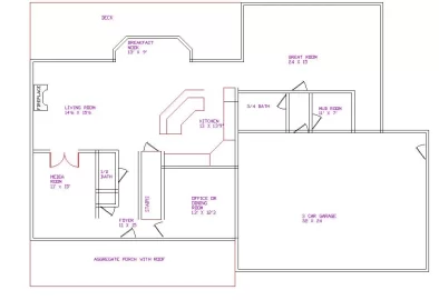

Hello! I could use your help!!! I am getting ready to build a new home and have time to make changes in the design to accomodate the right fireplace for our needs.
I am not sure of the terminology: We have an insert in our home now and we love the warmth it puts out with the blowers on. Something like that that looks more like a natural wood fireplace would be great (bigger glass? Less "stove-looking metal" blocking our view of the fire?). So I think I am looking for a fireplace insert that I will put stone around (hearth flush with floor) and then run the flue up through the interior of the house (boxed around of course). Right now, the fireplace is as shown in the attached sketch, but I could be pursuaded to move it closer to the kitchen (especially if there were reasonable 2 sided models out there!!).
We are not looking to use wood as our primary heat source. It is nice to be able to get some real heat out of it in the clod winter days. We have 5 acres of land to get some wood off of. We want to be able to not fear freezing in a power outage and we love the fire going- as long as it is really doing heating of the house and not just going up the chimney. Price is a consideration- we are people that prize function over looks.
Could anyone give us recommendations of size of unit that might be appropriate? Brands to search for? Terminology to tell me what I am looking for and what to avoid?
Thank you so much!!!!

DizzyB, I would suggest trying to get the fireplace and chimney into a more central location, otherwise it sounds like you are on the right track. Another alternative that you MIGHT find worth looking at is the idea of getting a Masonry Heater - these are usually not suitable for existing construction, but can be very nice if properly located and designed in a new home. Their fans claim that they are highly efficient and powerful heating units, and it is also possible to build things into them like bake ovens for custom breadmaking and the like. Do a search on the forums here for lots of threads discussing them.

Also, I can certainly look at central locations for the fireplace. I could see putting it on the north side of the powder room- would look pretty there! (see layout in first post of this thread) But I know one salesman said that it is good to take outside air into the intake for their fireplace. Couldn't do that if I went to a central location. Any comments on that?

However one key aspect of a masonry heater is that it needs to be centrally located. What occurs to me looking at your floor plan is possibly to build one where that kitchen island setup appears to be now. You could put the firebox facing the living area so people could see the fire, and have an oven built into the kitchen side...
