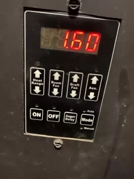

When you are talking about the exhaust fan settings, what kind of control board did you have? I know they changed them at some point. Mine is shown in the the pic. With it I can independently control the draft fan. I can either manually set it to a constant speed and control flow with the intake dampener, or I can put it in auto but program the low and high setting for it.
Making the heat sink for the top is interesting. It sounds like you wouldn’t want to increase the firebox heat past the integrity of the materials, but if you could increase efficiency so you can get the same temp room air using less pellets it would be nice. I actually have something kind of like that on mine from the factory. It is a large plate angled towards the front at the top of the firebox with a bunch of small holes in it. Not a great pic, but it is #11 in the parts diagram.

It seems like the controls looked much like yours. It was the very first version.....and yes, I got into the programming part of it and spent hours on the phone with the guy who designed the stove trying to get it to work. The control board just simply didn't have enough settings to get the fire to burn right no matter what changes you made to the programming. Maybe it had more than 4 draft fan settings?....all I know is that no matter what changes I made to the settings or the programming, you could never get a good fire......you only had a choice between smoldering candle or blow torch. I never even knew what the fire should look like until I gave up on the control board and installed the ceiling fan rheostat.
