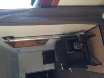

I have an American harvester 6039t and am having trouble with the settings. I've been reading the post on here and everybody has a manual damper they pull back and forth and I do not. I can not get the stove to not filll up. ( sure it doesn't fill up on heat range 2 but that doesn't heat the house) It runs great on heat range 4 room fan 9 combustion fan 4 auger setting at 1. It runs great for 8 hours but if fills up slowly. I've tried combustion fan at settings 4-9. Is there a way I can put a damper in this model? How many tines does everybody else's agitator have? Mine has 5, 3 on one side and two on the other. But it builds up in the corners of burn pot. Any help would be great and greatly appreciated. I live in Wisconsin its -15 degrees here and I have a 1600 sq ft house one level. Thanks again

The early models had no draft slide but it is refitable and sold on the USSC site. Makes a nice addition for controlability in addition to the outside air kit which I consider mandatory.
You didn't pay much attention to clearance to combustibles for your vent pipe, you are way too close to the sheetrock...... I would have gone directly through the wall and did the vertical ourtside. Less joints inside, less chance of leakage and easier to clean. Nothing worse than an inside cleanout Tee and fly ash.
Don't quite get what you mean by 'fill up'. You do not want the pot to fill up with pellets or corn, you want the pot to just have a light layer of fuel in the bottom, nothing more. A pot filling up is indicative of a blocked vent, ashed up interior or not enough combustion air.
Finally, where is the side cover? There are live electrical wires open to fingers there..... and don't expect the stove to heat 1500 plus square feet in minus temps. It don't put out that many BTU's and ir's a space heater not a central furnace. Mine augments the central furnace, it don't replace it and never will.

Thank you for the reply. I have the side cover off because I was replacing all gaskets in the exhaust motor. The reason it's not a direct out A) is because there was a wood stove where it is before we bought this house and that's where the hole was to tap into the existing chimney that wasn't being used B) I also live in a berm home (home built into the ground) and my walls are 12" thick.
There were times a couple months ago this unit had no problem heating the house with out issues. Even in negative temps. My agitator broke and I had the one with 7 tines. Ordered part from us stove company and I recieved a 5 tine agitator. Me being naive and new to prllet stoves I assumed maybe it was an upgrade. But it built up in the corners of the pot and no matter what I did with the combustion air it kept falling behind and the pot continued to fill up and agitator would no longer turn. Even if I turned heat range down.
There is good news here though. And I feel kind of dumb after the loss of sleep I've had for a few days because all of the cleanings I've done to this unit I have never vacuumed the hopper out and it had a ton of sawdust on the auger. So I cleaned that and put old agitator in even though it has 6 tines it won't build up in the corners. Wish me luck and thanks again for the info. I think I will be getting the damper option.

I agree with flip an OAK will help you greatly. Also the damper kit is a no charge I can get for you PM me if you'd like it. But IMHO once you put in the OAK the damper won't be needed. Also check below the burnpot, there is a 2" intake. Make sure the cap is off of it.
Lets distill it a bit.
First off, on the vent....
Are you feeding the vent into an existing masonry chimney (outside). Thats a no-no because the stove is too efficient and can't maintain the required flue temperature fot proper draw.
Secondly, the 7 finger versus the 5, the 5 is the later version (that I have) and yes, it tends to push a semi-hard chunk of ash towards the outer edge of the firepot, no issue, I put on a welding glove, take an old kitchen fork and scoop it out, about once a day at most.
Actually, you can pull the cap and drill a few 3/8 holes it it and replace it. That gives you enough secondary air. I'm still curious about how it's vented. If it's vented into a masonry flue direct, that could be the issue right there.
It is vented continuously through the pipe. It doesn't stop at the chimney hole. That pipe that goes into the wall also goes all the way up the chimney. I had a professional install it. Where do I get an OAK at? I put the seven tine agitator back in and cleaned saw dust out of hopper. It seems to be working great for the past 6 hours very little buildup on burn pot. And house is at 70 degrees. My heat rate now is 3 auger speed of 1 combustion "exhaust fan" at 7 and room fan at 9.
I looked at us stove company and can't find the outside air kit. Can I ask where u got yours?
Also there is no cap on intake under burn pot

With no fresh air kit, there should be. It's factory installed.
PM Owen on this site (he posted as well earlier) he works at USSC. He's in Customer service I think...lol, he'll get you one. Actually, it is on the USSC site under 6039-41 pellet/multifuel stoves. Seen it there before.
If you have a 4 button board (which I presume you do), I'd do a system reset first off (by pressing and holding the 'Aux up and down buttons together for 5 seconds, with the board hot and the unit plugged in of course.. That will return the board to the factory parameters (if it's not there for some reason). Then set the Heat Range at 5, room fan on 9, draft fan on 'Auto' and 'Aux' which is the agitator on 1, if you are running pellets only. In fact, leave the AUX on '1' no matter what the other settings are, if running pellets. 1 produces less agitator revolutions which produces less ash movement. The agitator is really designed for corn burning in a non-clinker pot.
If you don't have a 4 button board, order one up, it's a good investment and it's widely adjustable parameter wise.
Been running your stove for over 10 years, no issue btw.
I imagine with your cleanout inside, behind the stove, deep cleanings (which should be done at least monthly) are on the infrequent side, if at all. You really need to suck the heck out of the venting and get the fly ash out, it will probably run a whole lot better.
When you clean the inside of the stove, it's real important to pull both angled metal doors, left and tight of the burn pot pedestal and get in there with a bottle brush and get the ash from behind the wall.
I've never replaced the glass wool gasket on the CA fan housing. First time I opened mine up (for spring cleaning), I tossed the gasket and switched to red rtv for a seal. That was about 9 removals ago.
I still don't like that pipe so close to the sheetrock. It's against my judgement for a safe install and it really limits your access to the backside of the stove. Mine is a good 2 feet farther out than yours is.
If it had been me and my stove, I'd have taken my SDS hammerdrill and bored right through the existing chimmney and ran the vent all the way through with a termination hood on the end. Would have been a ton cheaper and easier to service.

Is this fresh air kit come in from the outdoors? Or can you get it from inside the house? I'd rather get air from inside of the house due to the possibility of a cold draft.
I only have the three button board.
That explains why you are missing some things (like a draft slide for instance). The early models of the stoves came with the three button board. USSC has the 4 button on the website and candidly, the only reason I upgraded was I roasted my 3 button and the 4 button was a plug and play replacement with much better operational parameters and more user friendly features so I got one.
Mine came with the FAK (Fresh air kit) in the box however (also known as an OAK outside air kit) on this site.....
I pull my combustion air from outside and thats my preference, why use heated air to feed the fire oxygen when outside air don't need to be heated (and the stove isn't a heater powerhouse anyway )so why pee the heated air up the vent....
I like the 4 button, I can change the fueling alogrithms to fit exactly my heating scenarios, set the draft fan or the room air blower exactly like I want them and the agitator too.
