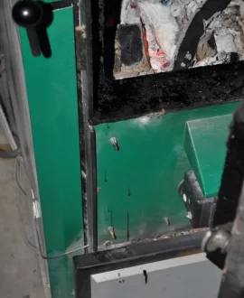

So it's not the door itself - it's the door flange. I think it's condensing on the sides and running down to the bottom lip. In the photo below there's a pool near the left end of the bottom lip. If the pool is deep enough, the bottom of the door 'insert' catches the top of the pool and drags it out so that it drips down the front. When hot it's the consistency of molasses. It cools quickly and is easy to scrape off of the door frame lip.

Could it be condensing on the supply air ducts and running down to the door lip and picked up by the door?

I think the condensation might be starting on the door side of the air inlets - probably the coolest surface in the primary chamber.
