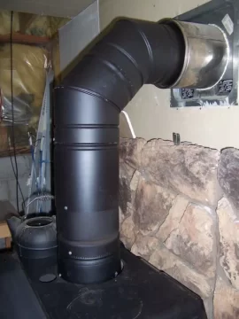

I had a 90, learned this last week from Stove guru.
I have 31 ". (top of stove to center line of metalbestos "T"
Stove guru guy told me to use two 45° s
Working so much better than before.
Thread here: https://www.hearth.com/talk/threads/73529/
Don't know rules there.
Stove guru said hearthstone equinox best non cat stove on the market for most heat.
That thread is here: https://www.hearth.com/talk/threads/73505/
