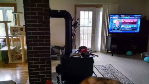

Ok. So here is what I got.
[Hearth.com] 7" chimeny for wood stove?
BUT, here is the problem! the seams on the 28" vertical piece and 8" horizontal peice dont seem to "seal"? for example I can see some daylight when I was looking through the pipes when putting them together... is that normal? how to you make that seal? or line up so it seals?! or does it not matter? it sure dont seem right... but I have a descent draft. before I put the elbow on I put a piece of paper up vertically and it sucked it to it, and held it up for a few seconds...
