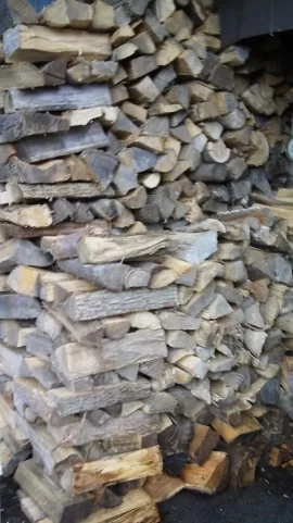

I like the biggest splits during the coldest part of the winter. I like the biggest splits for overnight burns. Medium otherwise as it gets easier to fit the small or medium sized splits into the stove. For sure we always start with a big split or a round in the bottom rear of the stove. That is one of the keys to overnight burns as that one will burn the slowest. Splits from 4" - 6" are pretty good for fitting them in but have some larger ones on hand.

I try to make big ones out of those bigger rounds. Making big splits always produces plenty of smaller stuff. However, if you are splitting for next year, go small. Better to burn dry.

I split 85 percent very big, about 8" X 6" splits or 6 " rounds unsplit. 10 percent medium size. 5 percent small starter wood. You can always resplit the biger stuff if needed. The only time I need to burn anything but the big wood is when we are starting a fire with no coals and the shoulder season. I sort the burn pile outside the door so I can easily find the starter wood.

The Oslo is not the largest stove, but you can get a 26" log in it. I burn at least 3 year old oak that's very seasoned. So I can get away burning 1 monster split on a 2" bed of coals and a hot stove. 2 monster splits fills the stove and burns well on a deep bed of coals. That's been my goal to keep the splits large and the burn time between reloads as long as possibly.

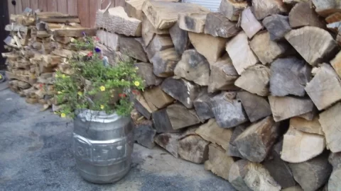

I think it all depends on stove/wood and personal preference too. The splits in your picture, I would be splitting them again.
I don't disagree. This will be year 6 for me and split size has grown as I have gotten further ahead. I have found that the bigger splits have significantly reduced processing and handling time while still producing plenty of the smaller stuff. The big square firebox in the King has no problem taking 3 of those big ones in my original pic on top of a healthy coal bed.
Again, if I was splitting for NEXT season, I wouldn't split anywhere near that big.
