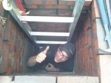

how do you remove a brick divider to make room for a liner? Santa style, of course!

Yah baby. How tall was that chimney? Looks pretty clean too. Not for the claustrophobic types.
I think there should be enough room for the liner.
pen
How is it theres a branch hanging in there?
That is one huge chimney......or maybe it's really just a small person :-P
cool picture...I cringed for a moment, feeling a little claustrophobic. Your chimney has no clay liners, you definitely have plenty of room for a SS liner. As far as removing a brick divider, you might want to go down head first next time. :)

To OP - nice picture, I do wonder though how you could work on anything at all once you got down there unless going in head first as another poster suggested, or did you work your way up from the bottom?
we had to run 2 stainless liners down the chimney. the original structure of the chimney was @ 180yrs old. someone did a new chimney top and basically stepped it in about 1' in on one side over 2 of the original dividers w/ steel plate and masonry. The oil furnace had a exhaust hole equalling about 2" tall by 16" wide coming up just under the big step in... unlined of course. I had to climb in, smash a hole thru the divider large enough to pass a 6" liner thru at about a 30 deg angle, at about 8' down, for a total run of 29' of liner. We also had to run a custom rectangle insulation wrapped liner down for an open fireplace next to it all, running thru another divider (I'm standing on the dividers in the pic, the ladder was just to assist me getting out, shimmying down in was not a big deal). We also put in a pellet unit (harman accentra) at this site, but that was a dv thru the wall install... had everything completed in about 9hrs. The furnace liner gave us the most trouble, took about 6 attempts to get it down.. it weren't pretty for a while.... just another day on the job!

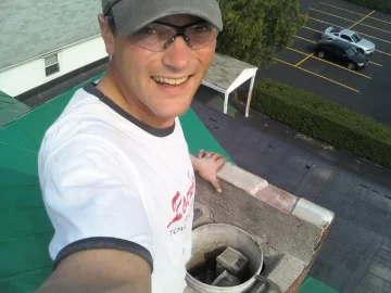

heres another good one... on a stepladder againsta chimney. we had to cut up a poured concrete cap on the chimney top and take out the piers holding it up to finagle a liner down... Not too sure how high up it exactly was, but the liner for the Lopi Revere insert was 27' long... and the insert was in a fireplace in a den on the TOP floor of the building.
