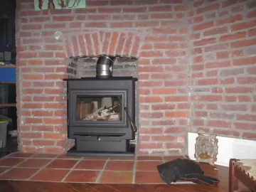

A little late here, post trigger pull, but here's what I've got: Firebox dims, 36"H x 25.75"W x 14" D; the 13NC sits all the way back into the firebox which leaved me 20" of hearth from the face of the stove (not door).
I'm sure I'd get better heat if the stove sat out further on the hearth, but this is my first stove and first year burning so I hope to have some years of discovery and experimentation ahead of me. We haven't had much real cold yet, but I'm sure I'll be happier and warmer than with the "forced dust" system.
