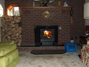

$900. bucks, in fireplace 30" high. NC 30 replacing a Regency Insert. Works awesome and keeps 1500 sf ranch style house 75 degress from one end to the other. Running block off plate with rear mounted blower and a small personal fan blowing @ the stove from 20' away. Best change I ever made.
  • [Hearth.com] Englander Insert or Stove?

To get the 30 though I would have to modify my hearth. I am hoping to keep it inside my fireplace. Could I remove a couple rows of brick from the floor of my fire box to allow the 30 to fit?
if you need to modify, then modify out --extend the hearth out and have the stove sit on it instead of in the firebox, you'll get more heat out in the space and less absorbed by the bricks above.
I have a flex liner now inside my firebox I can reuse that correct? Could I just build a hearth pad in front of my fireplace and set the 30 on it?
I heat about 1500 sq ft. with my NCI. If I were to do it again(when I do it again) I would go stove. I didn't put the surround on my insert for keeping more heat in the room and aesthetics. I like the hearth stove look vs a big black panel. Another thought on the insert, is the blower being in front...Loud!
