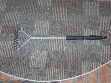

I bought a long handled grill brush just for that purpose.
  • [Hearth.com] Fireview scoop screen cleaning?
I haven't had much problem with my screen being clogged or the cat - but my wood is mainly oak and locust. I might try the steel brush like Todd has - good idea.
