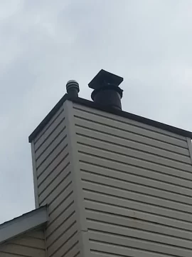

ok, so i have another issue, as i look outside i see another pipe sticking up next to my chimney, i would say 7 inches to the left, it is the how water tank exhaust, its definitely in my chase, im worried that if i open the wall this pipe will be in the way and it will get in the way of my clearances. what should i do, see pic

yeah it is in the chase for sure you will just need to open up the top to see what is in there. There is no way for us to know. It might be possible to switch the water heater to a direct vent so you don't need to run it all the way up. But no way for us to know that without actually seeing it. I think you need to get a sweep out to look at it and give you an idea of what needs done.
yeah may be possible to direct vent or power vent there are options but you need to get someone in to look at it. Also the wall you are going to be cutting a big hole in to make your alcove is almost certainly a structural wall so that needs to be taken into account also
