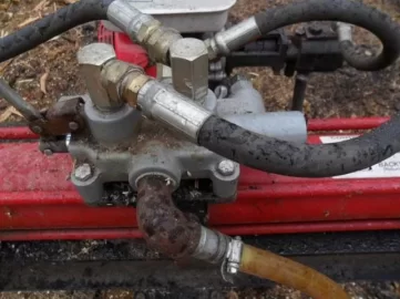

Well, looks like the return hose on my splitter split and needs replacing.
Looks like just a clear hose to me, with hose clamps on each end holding it to barbed fittings.

I would replace it with low-pressure hydraulic hose. That clear fish-tank tubing prolly doesn't like the heat from the oil. If your fluid isn't discolored/milky then I say keep it. You can add a filter no prob if you so desire.
Hyd. Fluid injuries are no joke. Gangrene can set in and you can lose that limb or worse.
No need to drain/refill the system if you're quick!
There is no pressure on the return line. It looks like the return line was replaced with a nylon plastic line. I would remove it and put on a low pressure hyd line. You can get it at any auto repair supply. Just tell them what size dia. and length. It looks like 3/4 but I can;t tell for sure.
If the fluid looks milky then replace it. Don't use heater hose as the fluid will rot it.

Get a proper return hose rated for conveying hydraulic fluid and simliar oils. This will be able to withstand the temperature and pressure of the hydraulic fluid. A typical return line on today's splitters is rated up to 300 psi. Make sure it's the proper diameter for your fittings.
I'd also look into replacing those rusted fittings, as they look like regular plumbing fittings and not hydraulic fittings rated for higher pressures. Even though the return line doesn't have nearly as high pressure, I'd still replace them.

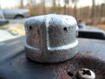

All done.
Relatively painless.
Drained the tank out of the return line fitting on the tank. AHoles didn't ever put a drain hole/plug on the thing., but could not get all the fluid out and could not see if a strainer is in place. I didn't want to take the supply line off.
I did use a pc of 14g electrical wire, fashioned a hook on the end and fished out the broken pc of the old plastic cap back out the fill neck.
The hose is overkill, but I like stuff that way, and it was all I had access to.
I put a new hydraulic fitting at the valve body and eliminated the old one at the tank and just threaded the hose end directly to the tank fitting.
The cap I made out of a pc of 3/4" threaded pipe, and put a standard pipe cap on top.
I drilled 5 holes in the very upper part of the cap sides, and took the old foam filter and s.s. screen from the old POS cap and fixed them up inside the new home made cap.
Permatex HIgh temp thread sealer on all fittings.
Split a bit and all is perfect.
Oh. also put 2 gallons on new universal hydraulic fluid and topped it off with about another 1/3-1/2 gallon of the fluid I drained out.
