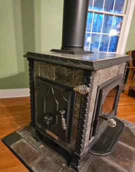

I also found a soapstone Hearthstone for $1100 it’s built in 1990 but it seems it doesn’t have the refractory fiberboard stuff my encore has.
I guess I’m asking if all cast iron stoves have this refractory stuff? It seems many people aren’t fans of the encore calling the ever-burn the never-burn.

Any thoughts about the hearthstone soapstone stove?
It will burn more wood and may need some repair work, especially if some of the stones are cracked and the frame cement is starting to leak air. It sounds like you don't need a project, the need for heat now is more important.

So the soapstone stove I mentioned is a traditional stove?
Is there a term/wording for traditional stoves or that have this refractory?
It is, and possibly pre-EPA with basic or no secondary combustion. Again with the caveat that a stove of that age is likely due for a rebuild.

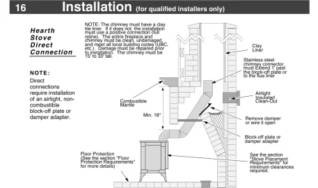

Here are basic side-view illustrations of wood stove secondary combustion designs that are typically found today. Hybrid stoves combine both.

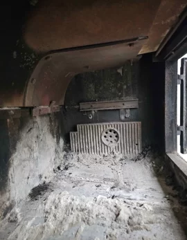

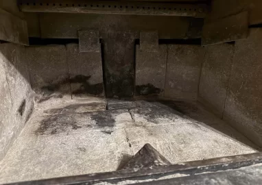

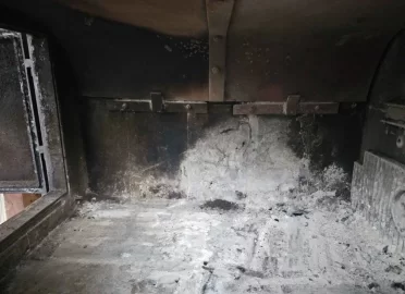

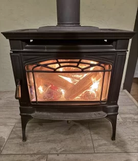

hey green, so I found a Lopi Sheffield. It looks to be a stove without the expensive refractory stuff but cast iron. It’s for sale of friends of friends. It’s a 2001 model but was installed and never used until
2017 and only as secondary heat/looks since 2017 so light use.
They were asking $800 but accepted my offer of $600 since I’m friends with their friends. My friends helped their mother bring it in the house and set it up but she had a stroke that week and it was never used, then my friend’s friend(one selling stove) bought the house in 2017.
It’s in a covered porch that is 15’x20’ and the heat really heats that room and doesn’t get into the house so co sundering that room was meant to be a 3 season room they want to free up space where the stove is and have no reason to heat it in winter.
Any info on Lopi Sheffield’s?

Wow, I haven't heard that name for a while. The Sheffield was a nice stove. Good looking and well built. It's sort of an old school Lopi with a firebrick on top of iron baffle. My main concern is that at 1.3 cu ft, it's a bit on the medium small side. Still, at that price it's worth trying it out for a season.
PS: That's a haphazard way of loading a stove. Too much air between the splits.

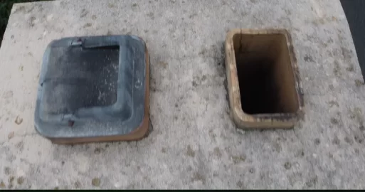

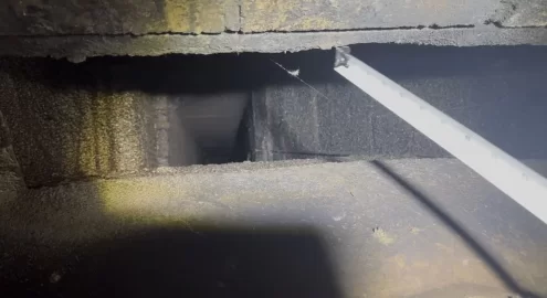

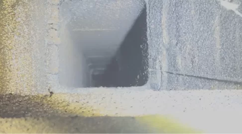

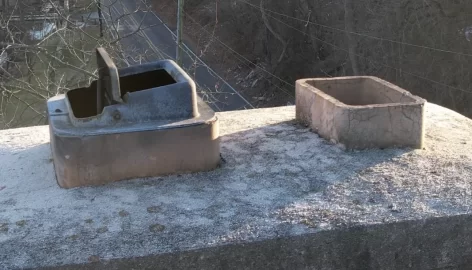

Chimney liner appears to be clay and distance between joints look to be 18-24” apart.
Looks to be 10-12”x 10-12” wide.
So it seems the flue cap opening is 7x11” and the liner is wider.

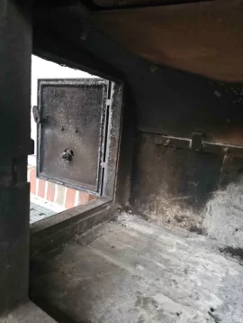

Damper door was removed before I purchased the home last year. 7” clearance where the tape measure is shown.
Of the 6 approved installation types I may go with this to start, then add the insulated chimney liner next year.

That could be good news if its ID is 10" x 10". That ID is good for putting in an insulated 6" liner. However, it definitely is not ok for a direct connect of a stove that has 6" flue requirements. A 6" flue has an area of about 28.3". 100 sq in is 3.5 times the area. This is not permitted for 6" venting requirement. It will weaken draft and cool down the flue gases too much. This could end up in poor performance and a creosote trap as a result.
Reactions: GG Woody
That looks to be a nice clean chimney, and looks to be in good shape!
Now is the time to get a liner in there, not after there's a bunch of nasty crispy creosote in there.
I wish I had a liner like that to work with, looks ideal!

well good news, I found the drone footage I took of the chimney this spring and confirmed that the measurements the roofer gave me of the 2 flues were wrong, he said bother were 6.75"x11" and as you can see the two flues are different sizes and the flue on the left(the one for the fire place) is square so it can't be 6.75"x11". looks like my initial estimate that the fireplace clay liner inside measurements was somewhere between 10-12" was correct. so a 6" insulated liner will go down a 11x11" chimney liner just fine.
what do you think of the register/closure plate mated into the multi fuel adapter the English guy had going on?
I will put a metal cover over the small flue(one that fed the basement oil furnace) and thinking of putting a flush mounted chimney cap over both flues

That's good news. Ideally, it would be better to elevate the new woodstove liner end to 12" above the basement flue. This will help prevent back-siphoning of smoke down the basement flue, which can happen due to negative pressure in the basement.
